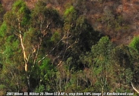

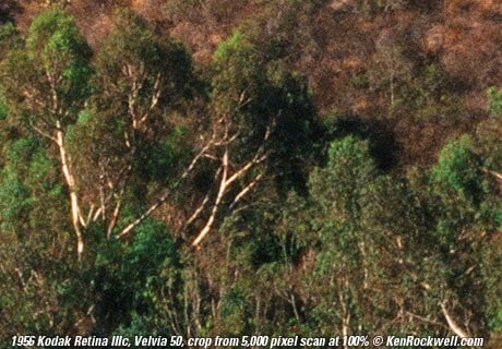

The 1956 camera, with its fixed 50mm f/2 Schneider Retina-Xenar on Fuji Velvia 50 and a good automated scan, has better resolution than Nikon's state-of-the-art digital!
Hee hee! One day I'll have to shoot a modern camera and have a real scan made from 35mm, which will be much better, and maybe I'll even compare to the current state-of the-art in 35mm digital, which is Canon, and is also better than Nikon.
Digital is easier and cleaner, but even 35mm film shot on a 52-year-old camera still has more sharpness and resolution. The Retina camera and its meter both work without batteries.
http://www.kenrockwell.com/kodak/images/retina-iiic/resolution/01030036.jpg
http://www.kenrockwell.com/kodak/images/retina-iiic/resolution/D3R_2830.jpg

Mal ein einfaches Beispiel bei der Landschaftsfotografie:
Mache ich ein Bild mit Ästen und Bäumen wie bei Ken Rockwell, sehe ich ungefähr denselben Effekt wie bei seinen Analog/Digitalvergleich. (gemeint sind diese Bilder: http://www.kenrockwell.com/kodak/images/retina-iiic/resolution/01030036.jpg http://www.kenrockwell.com/kodak/images/retina-iiic/resolution/D3R_2830.jpg)
Nur eben hier mit einer 10 MP und 24,6 MP Kamera. Die 10 MP Bilder werden wohl kaum so feinauflösend die Äste und Bäume wiedergeben können.

A frame of 35mm film, scanned cheaply at a good photo lab to a CD, is about equal to the resolution of a 25MP DSLR.
When doing film vs. digital comparisons, I prefer to compare like to like, and compare larger formats of film, as shot by most pros, to the DSLRs used by most pros. 35mm film is an amateur format, so I've never bothered to compare.
I was shooting a 1956 Kodak Retina IIIc, and out of curiosity had some automated 5,035 x 3,339 pixel scans made at NCPS. Just for laughs, since these scans looked so good, I shot the same thing with my 2008 state-of-the-art Nikon D3 (that cost me $5,000) and 24-70mm f/2.8 AFS lens (that cost me $1,700) to compare to the Kodak.

Die Retina IIIc ist eine schöne kleine Kamera mit einem sehr guten Schneider Xenon. Trotzdem bezweifel ich diese Ergebnisse vom Vergleich.
Mir ist noch nicht aufgefallen, dass meine Retina mit Velvia meine 1D in der Auflösung
schlägt.
Mir ist auch nicht klar, womit das Retina Dia gescannt wurde.
Ein Trommelscan scheint es nicht zu sein, oder?
Hat die D3 vielleicht einen Fehlfokus.:D

Ehm das ist ein 100% Crop aus einer Zoomlinse vielleicht mit 12 MP-Auflösung?... Das nenne ich einfach fehlende Auflösung dank der 12 MP um noch die feinen Details der Bäume und Äste zu zeigen. Sprich die Äste und Strukturen an den Bäumen werden einfach zu ,,Pixelmatsch".
Mehr geht nur mit einer +12 MP Kamera (besser +20 MP) ansonsten Bayern-Interpolation viellecht oder AA-Filter? :ugly: :top:
Das Velviabild erinnert stark an meine Alpha 900 in seinen feinen Details. :D
Nicht umsonst sage ich hier bereits, erst mit einer +20 MP Kamera ist das analoge Format auch in der Auflösung endgültig besiegt und nicht mit einer 12 MP Kamera. :lol: :evil:
Ich denke der Ken scannt mit 8000 DPI bzw. etwas weniger hat bestimmt eine Nikon Coolscan rumstehen oder weiss der Geier was... :ugly:

Ehm das ist ein 100% Crop aus einer Zoomlinse vielleicht mit 12 MP-Auflösung?... Das nenne ich einfach fehlende Auflösung dank der 12 MP.
ähm, das ist ein 118%-crop.
auch wenn ich digitalverweigerer bin, halte ich es doch unter normalen bedingungen (freihand etc.) für sehr zweifelhaft 12-15MP mit Film zu übertreffen und ken rockwell.... der ändert auch alle fünf minuten seine meinung.
Stimmt, da steht 118%-crop, mein Fehler. ;)
Auch ist der Vergleich lustig, Zoom vs. Festbrennweite. :lol:
Wobei das Nikon 24-70mm ist alles andere als eine ,,unscharfe" Linse, dass sind schon Zooms (24-70mm f/2,8) die gefährlich nahe an Festbrennweiten ran kommen, zumindest in Sachen Schärfe. :ugly: Und ein 24-70mm f/2,8 Zomm ist normalerweise beispielsweise bei 50mm alles andere als schlecht.
zusätlich täuscht das motiv, durch das korn erscheint es als gäbe es mehr details, weiters fällt es in diesem fall auch nicht so auf.
außerdem sehe ich keine exifs und hinweise zur rauschunterdrückung.iso, blende, belichtungszeit, gleiches objektiv,..
bei diesen bedinungen schaff ich das testergebnis auch umgekehrt :D
